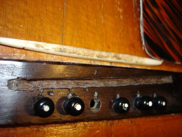

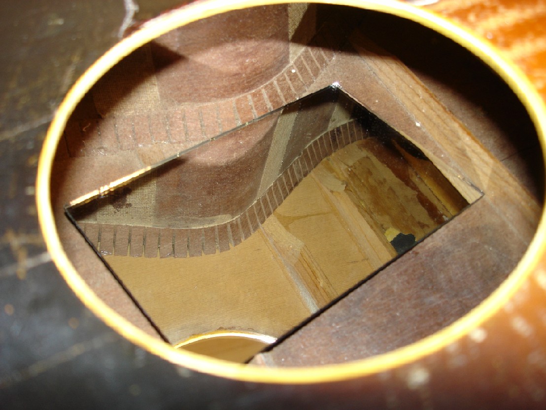

The bridgeplate -
As you can see – there is no wood between the bridge pins. I’m not sure, but I would guess that the glued paper may have been added at sometime to either help prevent the bridge plate from cracking, or to keep it from getting worse. And as I said earlier this bridgeplate goes all the way across the top – from side to side. It looks like it was made from spruce, which may explain why it looks on the thick side to me.
I don’t know how (or why) you would repair a bridgeplate in this kind of shape (both literally and figuratively speaking). I’m thinking that it needs to be replaced, and the replacement be made the size of the bridge (not the full width of the top) from better materials.
I’m thinking this would impove the sound.

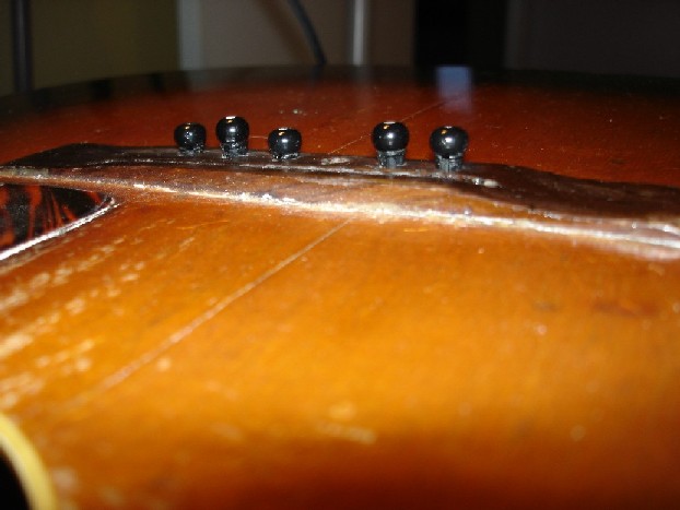

The saddle is about as wide as it is tall. Would you believe – there was lint balls and dirt underneath the saddle down in the slot. The slot in the bridge looks like it was carved out with a pocket knife – heck the bridge looks like it was carved out with a pocket knife.
As you can see, there isn’t much bridge height. And you notice the bridge pins aren’t seated all the way down.
And a close inspection of the top around bridge area suggests that this was either a replacement for the original – or the original had to be re-glued. Sloppy work.
Instead of replacing the bridge, I’m tempted to try and square up the sides and bottom of the slot for the saddle and not replace the bridge. Mainly, because I don’t want to have to deal with neck angle issues with a new taller bridge.
I need to ream the pin holes and replace the pins.
I’ve order a bone saddle blank (little larger than the slot is now) and bone pins.
I don’t mind the appearance at all. Actually, I think it adds character – she is this way because… But these are the kind of improvements I think can be made.

I'd say the bridge plate is the tricky (and necessary part of the repair. Hopefully you will get some ideas from experienced repair people about how to do that. In the meantime you might consider some conservative methods for getting that sandpaper? off the bridge plate without removing the plate.
[QUOTE=tony]
I'd strongly suggest leaving the bridge pin holes at the current size and shaving down/turning down the bridge pins if the looks are important to you. Somebody with a lathe and a few minutes to improvise could do this for you, or you could probably figure out a way to do it by hand with a simple jig. Functionally, the pins are probably doing the job as they are.
I'd also not worry about the bridge height too much at this point, though it was probably cut down to 'improve the action' (kinda a cheap alternative to a neck reset) at some time. That would explain the 'deepening' of the saddle slot, since shaving the bridge would have left the slot too shallow. This is also why the pins don't seat properly, since they are sitting in the taper at the original height- the pins are showing you where the top of the bridge once was.
Cleaning up the bridge slot (esp the bottom) and making a new saddle should improve the tone. Again, I would be careful not to make the slot any wider than necessary- it's fairly easy to sand down a saddle to the required width, as you know.

Okay, Tony, here's my 2/100ths. You'll be sorry if you put all that work into this guitar, and don't reset the neck. Your stated goal is to make this baby sound its best, but it won't without a proper neck angle. That, of course, ties in with the bridge. It's just too low. I agree with John that it has probably been shaved down to avoid a neck reset (always a bad idea, IMHO). The bridge functions as a brace, too. It's not just there to hold the saddle. Gotta make a new bridge. The bridge plate: think of it as a low, wide brace. I think that Gibson, for better or worse, put it across the body width for structural reasons. It needs to be replaced, full width, with spruce. Now, to beef up the plate's string-holding ability, I'd suggest gluing a maple veneer over the spruce where the string holes go. It'll then be just like new, only better.
This guitar is just too beat to have collector value, but it would be much more valuable, both monetarily and to a player, if it is restored. Keep everything as original as possible, but make it playable. There's still some good music inside this honey!

Carltons right on the money, but that's a fairly high-skill set of operations. (I know from experience- the first reset I did was on a dark sunburst guitar and had to spend hours hiding finish chips around the neck and fingerboard.)
However, your pics show you're comfortable working through the soundhole, so it may be a good project. I'd probably 'rehearse' on a newer junker guitar, but I'm a bit of a coward about these things.
You can always do the minor stuff- fix the saddle slot, etc and see how you like the guitar. Then you can move on to the major repair (neck reset, replace bridge and bridgeplate) later.
BTW, that bridge plate looks like it might have epoxy on it, which could make things interesting.

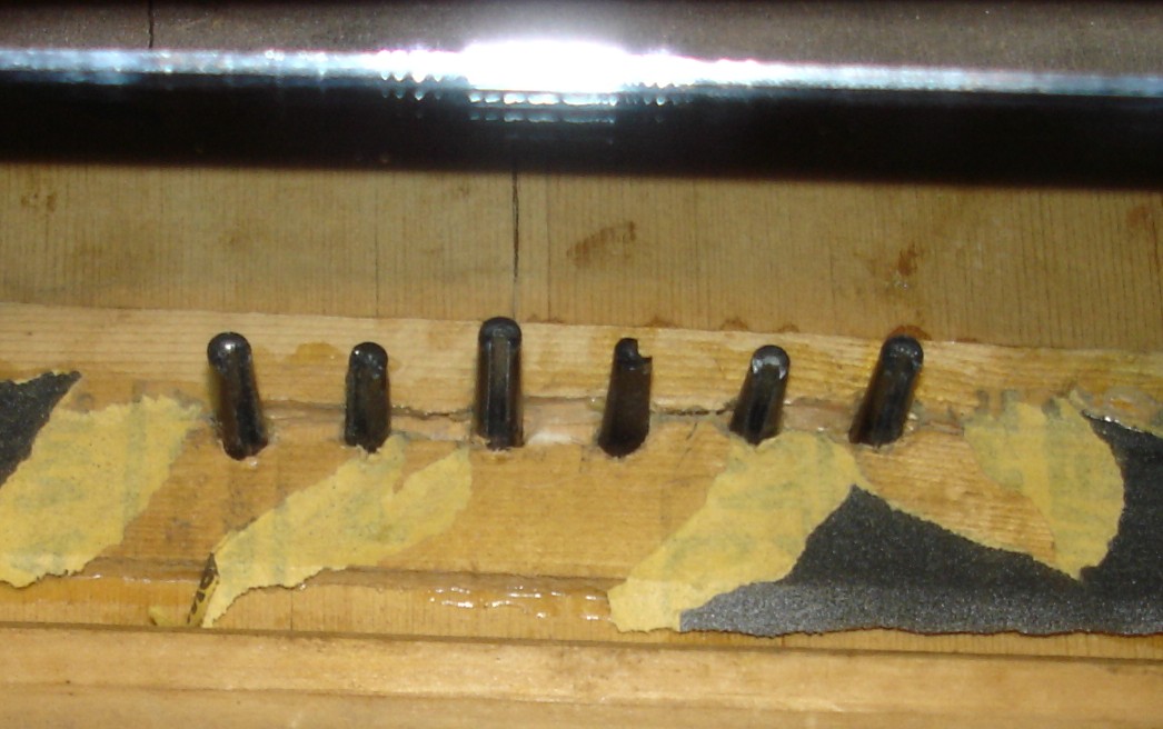

I just repaired a bridge plate today on a 30's Kalamazoo that looked
exactly the same as yours. The plate may not need to be replaced unless
you are trying to flatten out the top. If the chipped / worn spruce plate is
the only problem it can easily be patched and lightly capped. Unless the
top is seriously warped I would certainly not recommend pulling the
plate. If it did require pulling you would really have to replace with the
same size as the original, definitely no smaller. I just replaced a plate like
this on a 190x Vega flat top about a week and a half ago to flatten out a
seriously bellied top. With the Gibson top crown of the 30's this is rarely
an issue, even with a ladder braced guitar.
As to the bridge pins, dump those plastic slotted replacement pins that
are on it and get some unslotted ebony pins like it would have originally
had. Don't do any reaming until you have the new pins to fit. On the one I
just did I filled the missing spruce and glued a .050" maple cap just large
enough to cover the holes and support the ball ends.

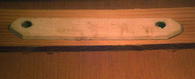

I wasn't photographing this repair, but since it came up I went to the shop
tonight to pull the clamps and take some quick shots. For the missing
spruce I simply cleaned up the edges with a razor blade and a short piece of
a file, then fit and glued in a piece of spruce to fill the gap. Really a 5-10
minute job. Then is the typical bridge plate cap - just a solid surface for the
ball end to bear on. I use thin hard maple or rosewod depending on the
original plate.
PostPosted: Wed Apr 11, 2007 5:07 pm
Posts: 2060
I hadn't drilled the inner holes yet, but I pre-drill the outer two so that I
can use two 3/16" drill bit ends to locate it as I am placing it on the plate.
Then clamp, drill, clean up with reamer, and slot for strings. Not much to
it really. The spruce patch beneath the plate does not need to be perfectly
clean, and I could even accept debate as to whether it was necessary at all
under the cap. Still it didn't take much time, and I prefer not to leave a
hollow chamber between the cap and the top.
I often use the StewMac bridge plate repair / plug tool (one of the best
tools they've come out with) for damaged plates. In a case like this
however with a full missing section, I still prefer the cap. The one pictured
above is about .050" thick, although the beveled edges make it appear a
bit thicker in the photo.
Tony, in your case the time consuming part is going to be cleaning up
slop from the previous "repair". Scraping, sanding, time, patience, and
caution. It shouldn't be terribly difficult.
The instrument in the photo above is a 1933 KG-11. It had already had
the neck reset and been refretted, and was certainly worth having the
work put in to it. These can be absolutely excellent guitars, and have
really started to rise in value faster than I think most expected in recent
years. Take good care of it and you'll be quite happy.

OK. Back with some maple. A friend who is a luthier gave me a slab to cut from. Question. (excuse my ignorance) What is the best grain orientation for a bridge plate?
PostPosted: Thu Apr 12, 2007 12:06 pm
Posts: 2060
When making the bridge plate itself I prefer quartered, parallel with the top
grain with X-braces, perpendicular for ladder braced. For a small bridge
plate cap however quartered or flat will be fine. It's function will not be for
any top support or transmission of vibrations through the top, but simply as
a hard stable surface to support the ball ends. Harder the better.

PostPosted: Fri Apr 13, 2007 8:17 am
Joined: Sun Apr 09, 2006 3:26 pm
Posts: 118
Top and bottom shown.
Of interest. Cloth used to reinforce the sides and under the kerfing. Top and bottom braces and bridge plate are tucked under the kerfing, but have been narrowed next to nothing before they enter.
Hope this satisfied your curiousity. If not let me know what else you would be intereseted in...
